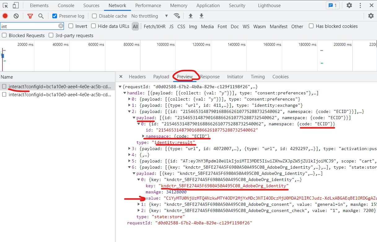

@jgrubbs  "CORE" is the namespace for AAM identifier (I think this is the UUID and that is the reason for the mix up). The konductor (Edge) sets the ECID server side and also ECID lives (I think in an encrypted format) in the konductor core identity cookie. In every request to Edge, you will see a "query" under XDM, where alloy goes and asks for the ECID. You can actually see if this would be resulting in a successful ECID in the response ("Preview" tab of the Chrome debugger). Here you should get the ECID along with the namespace under "identity:result" like in the screenshot. (Please do this as a new visitor from clean browser window).

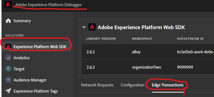

You can also see this with the help of Adobe Experience Platform Debugger:
Bottom line, you should see the the ECID under the right namespace and not under "CORE". Check your Data Stream settings for Audience Manager, if any, disable and try once. Also check your Web SDK (alloy.js) configuration in Adobe Launch and make sure you have identity migration enabled.
In your debugger, you can also see a validation of the call. If that goes through, then you should have no problems in ingesting the data/batches. My sandbox is down, so I am not able to send you a screenshot now, will send once it is back.
