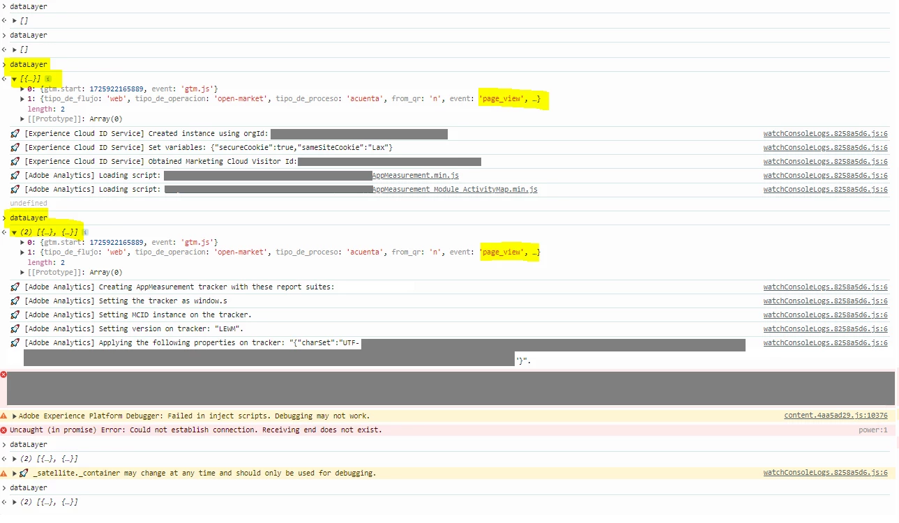

I see that by default the CORE extension is capturing the dataLayer events, and I have not had a problem with the click events, but I have a problem with the page_view event which is inserted into the dataLayer every time the page loads, as I see which CORE does not always recognize.
I have done some tests. I see that when I reload the website several times, sometimes the CORE extension does recognize that page_view event but it is quite unpredictable and I don't know exactly why it captures it at times and at other times it doesn't. I thought maybe the dataLayer wasn't filling before Adobe loaded but I've noticed that if it is full by then, I also thought maybe it doesn't recognize that first event because the event is sent to the dataLayer before and CORE doesn't recognize the change in dataLayer.

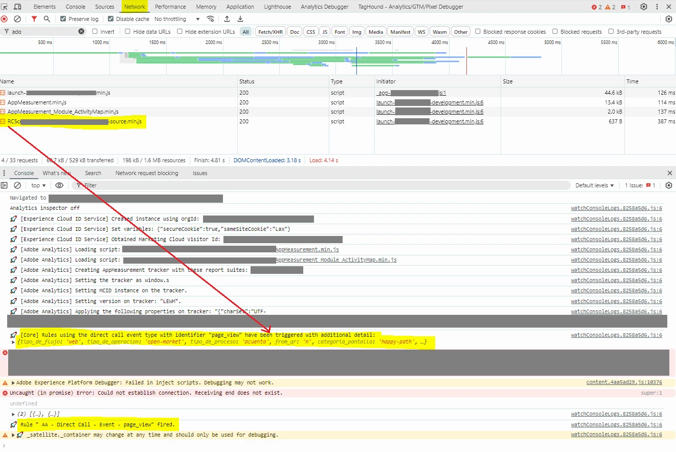

here I reloaded the page and the CORE extension recognized the page_view event

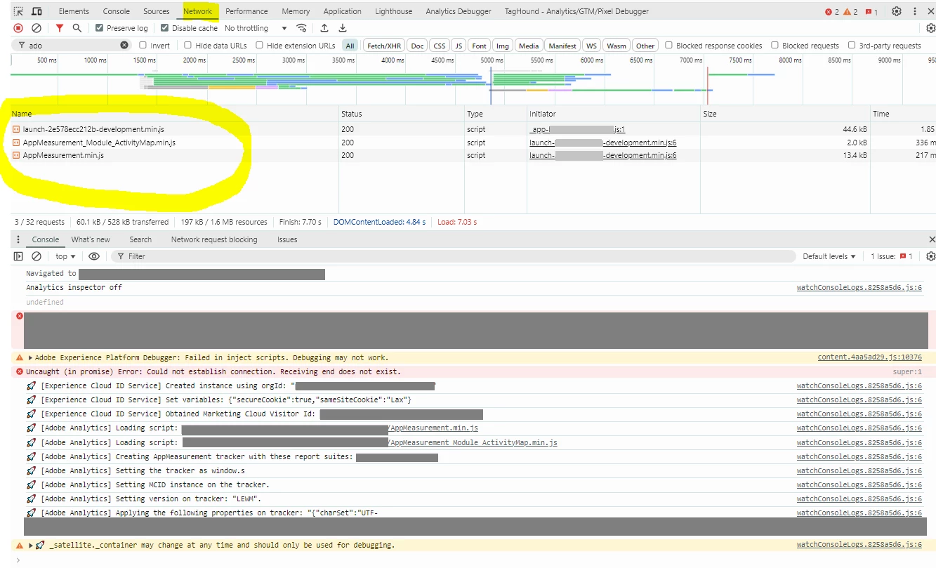

here I reloaded the page and the CORE extension did not recognize the page_view event

thanks for your response. Yes, it seems like a timing problem, although I don't know what it is due to. But I have noticed that when the CORE extension recognizes the page_view event I can see in the browser network that a min.js file is generated.
here the CORE extension recognizes the page_view event
and here the CORE extension does NOT recognize the page_view event

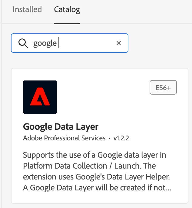

And answering your question about the extension. Yes, I tried using the Google Data Layer extension and also the Adobe Client Data Layer extension but I still can't get it to work the way I want.
Here I actually installed both to check how they worked

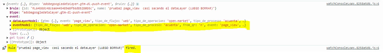

With the Google Data Layer extension it seems I can get the page_view event to always be recognized. I have tested that if I enter the page for the first time or if I reload it, the rule always activates, however, the most it can do was show the entire event. But I can't find a way to extract the information from eventModel
I thought that perhaps placing event.eventModel or in the case of wanting to capture the value of a parameter, placing event.eventModel.tipo_de_flujo would be enough but this is not recognized by adobe launch although console.log(event) does work since that is how I printed the event in browser console

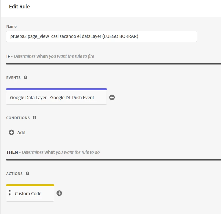

At the moment only he created this rule to test:
RULE:
EVENT
ACTION with console.log(event) to print the result to the browser console
