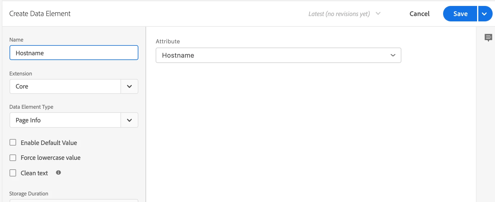

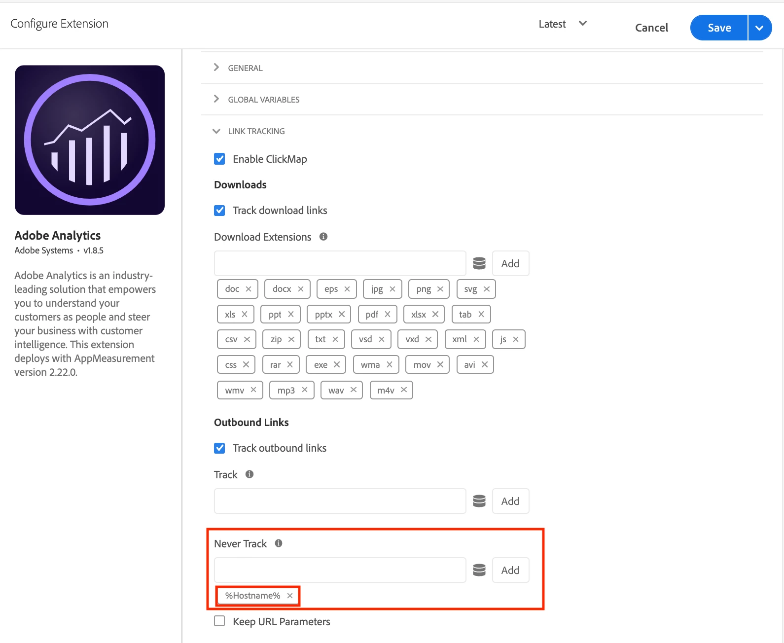

Here's the trick:
1) Create a data element as shown below
2) In the Adobe Analytics extension configuration, under Link Tracking > Outbound Links > Never Track, add the "Hostname" data element created in step 1.
3) Save to Library and Build!
Cheers,
-Stew
