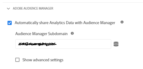

     1. I enabled automatic data sharing with Audience Manager in the Adobe Analytics extension settings.

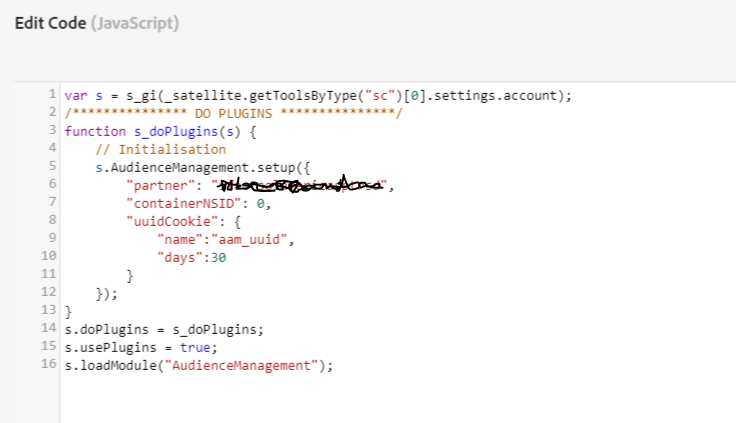

     2. In configuring the tracker using custom code, I added the following code indicated by the documentation (documentation link: Analytics to Audience Manager Implementation Guide . I am using the server-side integration).

  • Delete the custom code you added in step (2)

I removed the custom code added in step (2). My SSF was already enabled. My problem still persists, do you know if there are any more settings to be made yet?

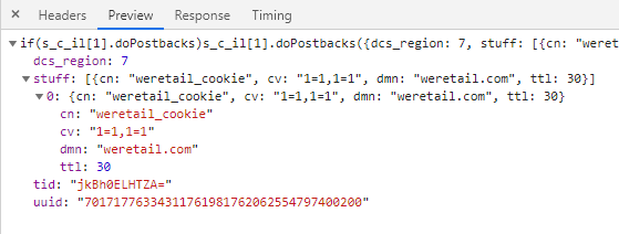

How do you define that the problem persists; could you share the http response from the AA tracking server?
This is my http response from the AA tracking server:
My segment synced with AA when I created a new destination config. But I can't see any signals on my AAM.
How can I do to see signals being captured in AAM (preferably in real time)?
This response means that SSF is working correctly.
You may not see the signals in AAM because of low traffic volume. There should be at least 1000 hits per signal to be displayed in the AAM Signals Search UI.
