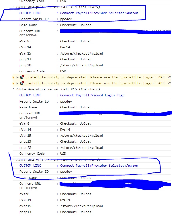

How to prevent direct call rule from firing twice?

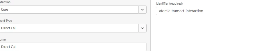

This is the trigger
I know its firing 2 times in console but max frequency didn't work in this place. Does max frequency controls frequency for only one direct call firing? Can we write some custom code in set variable section like

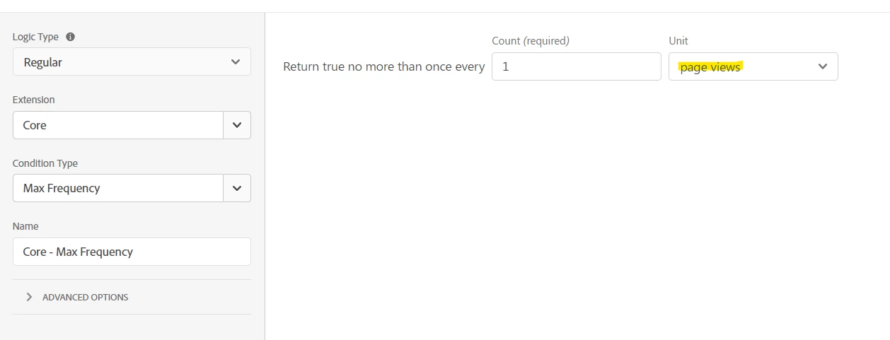

Now, for the Max Frequency, you didn't really answer how you configured it.. but since this event seems like a generic event used for multiple different items, so this may be why the "max frequency" isn't working.... this may be loading first on the page load, then for something else, then this behaviour which is triggering twice...
But if you are using Max Frequency based on the "Page View"
This is probably your issue, as this event has likely already fired on the page....
Try a Max Frequency based on time:
This still may not work depending on how many atomic-transact-interaction events are being fired on your site....

I tried max frequency in condition and the rule stooped working completely. I used s.abort in the custom code it stopped other rules from firing.

What sort of trigger is being used?
Also the "max frequency" condition should have worked (and not caused a complete failure)... could you maybe share some screen shots of the condition you tried?
While fixing it with Launch is technically feasible (this is where I would be recommending the Max Frequency), I am curious if there is another root cause that would explain the double trigger.
