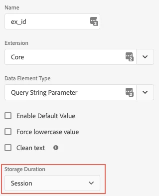

If user clicks on our ad and QSP ?ex_id=123456 is appended to the URL of our landing page, is Launch able to store that QSP? I want to later retrieve that same QSP value from the landing page at the point of purchase, in the same browsing session, and insert that value in a parameter of a marketing tag.

@chischa - Of course.
Just create a new data element and set the "Storage Duration" option to "Session" (or whatever duration you need). When you're ready to add the value to your marketing tag, just reference the data element.
