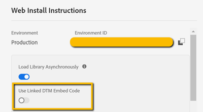

Best answer by kainth
Hi @jmk ,
You can try using the option "Use Linked DTM embed Code" as that will allow you to use DTM embed code to serve the Launch library. For more information on this feature, you can refer to the below link.
Link: https://docs.adobe.com/content/help/en/launch/using/reference/upgrade/link-dtm-embed-code.html
The way it works is that it takes the most recent changes. For example, if you are using the DTM embed code & you publish any changes in the Launch Property then the DTM embed code will start reflecting those changes on your site. Now, if again you try to publish new changes via DTM then the new changes which you made in DTM will override the changes made in Adobe Launch.
Hope this helps.
Abhinav
kainthAccepted solution
Level 6
July 16, 2020
Hi @jmk ,
Hope this helps.
Abhinav
