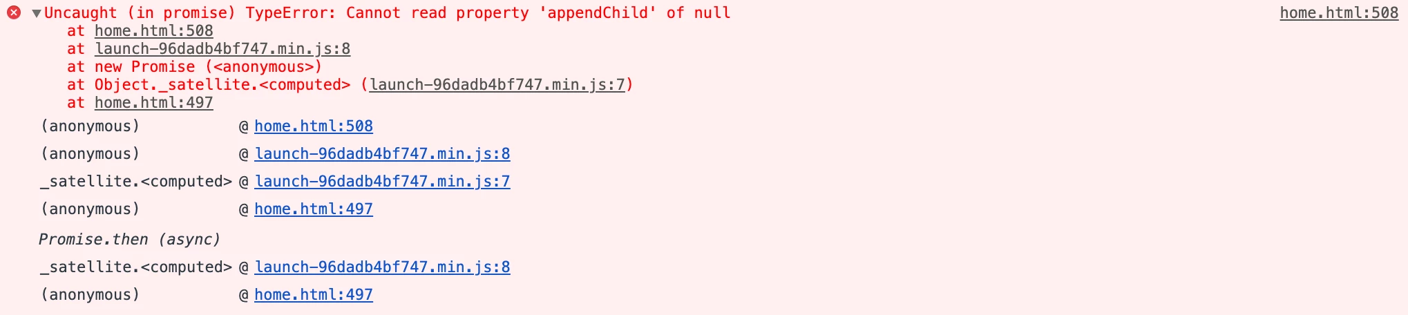

Thank you for sharing the link!
First, pay attention to the errors in the console. Here is what I could see on the first page
and the following error is on the contact us page (second page):
Regarding the tags that may fail to fire, I have looked at the setup with the Launch Inspector and did not find the rule "PL : Top : All Pages". However, there is a rule "PL : Top : All : All Pages" with some custom code that should fire gtag.
