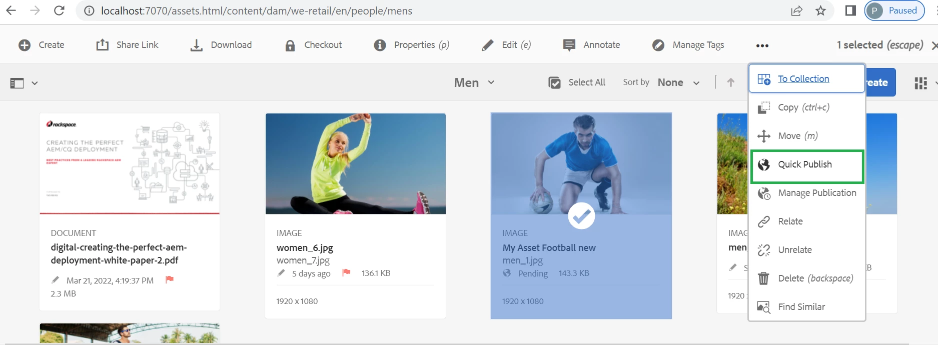

1. If you are planning to publishing first using Quick Publish as shown below and then you want trigger the custom workflow -
Then please refer approach as @Nitin_laad has suggested.

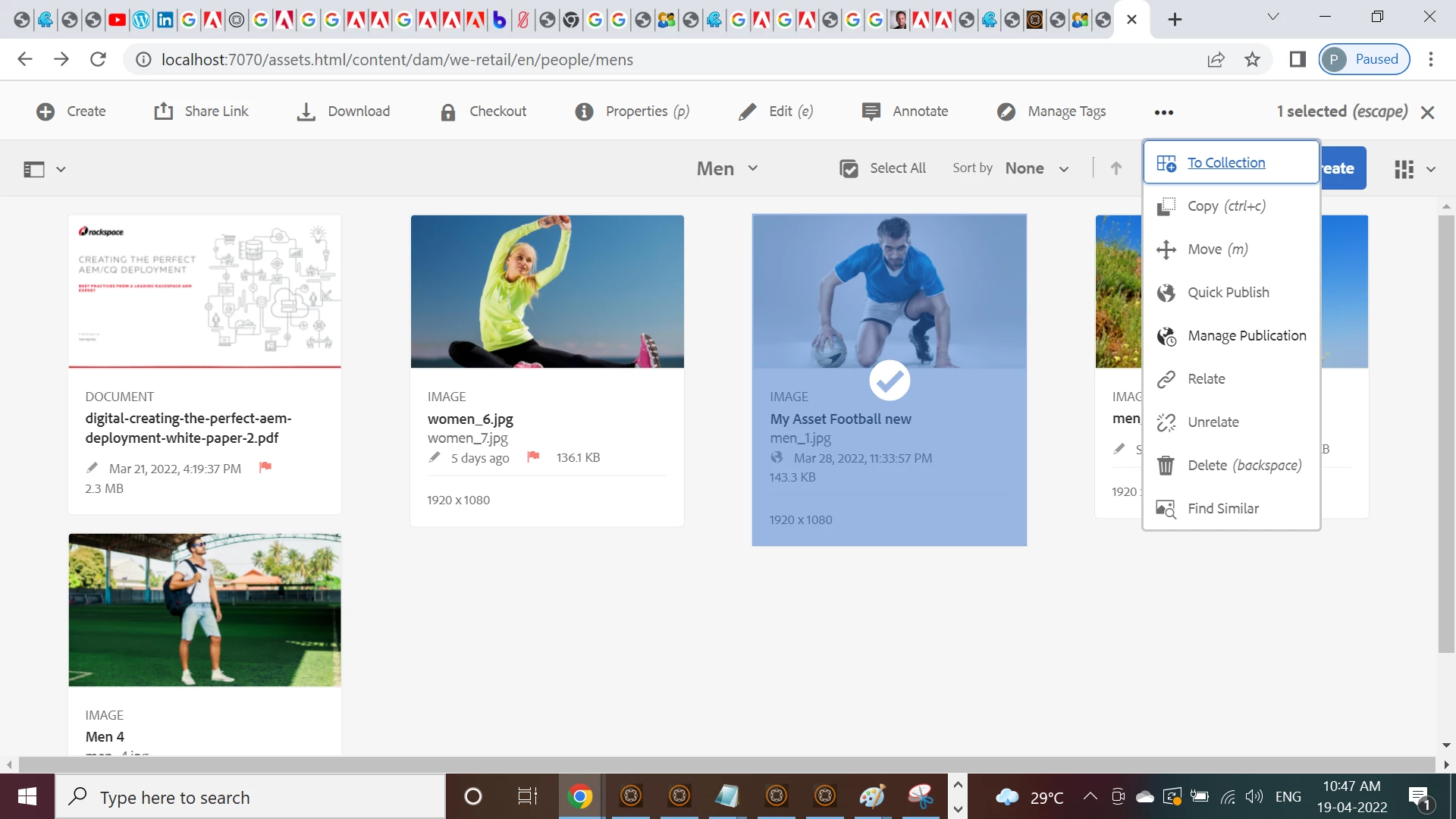

2. If you are planning to manage via Manage Publication as shown below -
Then you can follow @Bhuwan_B and @ManviSharma here.
