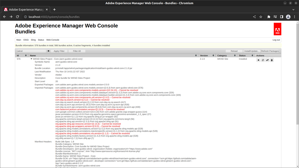

I am using AEM as a cloud service. After installing WKND Site v2.1.0 from github
Please help me find the solutions on this.
Thanks in Advance.

Check whether your core component bundle is active or not. [com.adobe.cq.core.wcm.components.core]
Hi @Sady_Rifat
It's Active!
Please check the version compatiblity for the wknd project.
It seems the dependencies which wknd project expect, does not exists in AEM version

Hi @neeraj_24412,
As per @arunpatidar Please check version compatibility for current version of AEM and WKND project, you can check here [0] for more details.
Additionally, worth checking about Get started with AEM Sites - WKND tutorial [1]
[0]: https://experienceleague.adobe.com/docs/experience-manager-core-components/using/versions.html?lang=...
[1]: https://experienceleague.adobe.com/docs/experience-manager-learn/getting-started-wknd-tutorial-devel...

@arunpatidar @SantoshSai I have checked the compatibility seems fine to me!
Yeah,When I downgrade to v1.1.0 It works but with this command
$ mvn clean install -PautoInstallSinglePackage -Pclassic
Thanks, @SantoshSai @arunpatidar @Sady_Rifat
