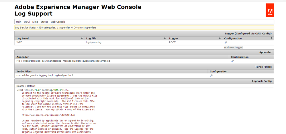

the replication errors are not related to your problem.
The fact, that you have only this small number of entries in the /system/console/slinglog screen (only 1 logger and 1 appender) is interesting, because a default AEM comes with some more entries (it writes a request.log, an access.log, update.log etc). So either you have messed with the default configuration (I would never remove loggers, but only add new ones) or the system you are working is in a way broken.
The exception "org.osgi.service.cm.ConfigurationException: oauth.config.id : Config Id must be unique" shows me that you have played with this instance quite a bit, so maybe rebuilding it from scratch is much faster than diagnosing strange issues which arose out of experiments with AEM.

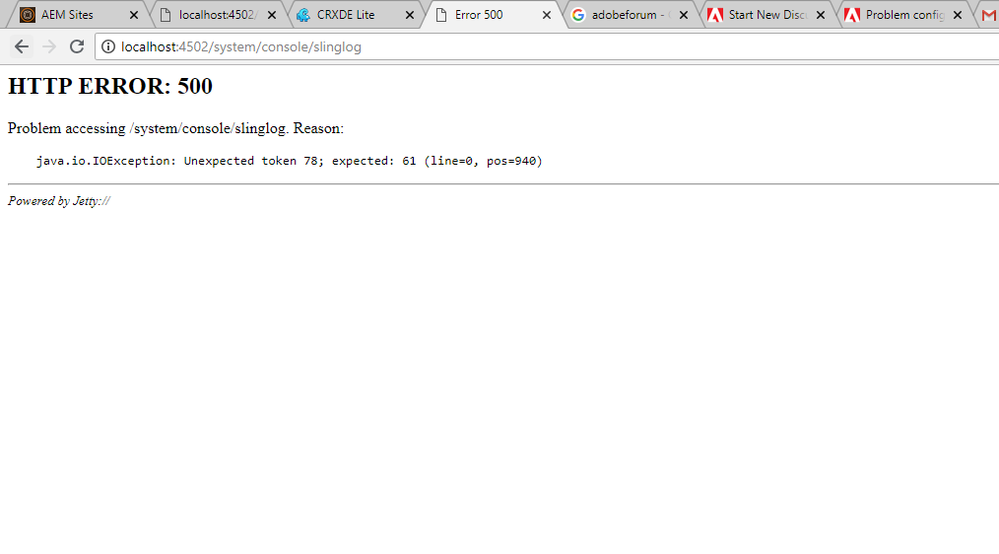

I am just trying to see create log file normally Just adding new logger for my component very basic idea of putting logs for my component.
My log consol is looking like below there is some problem with my log suuport console or ned to restrart any particular log bundle?

Yeah this problem is related to instance it seems ..I attacheed the screenshot also like my log console is looking like that only which is not normal I am getting error .
