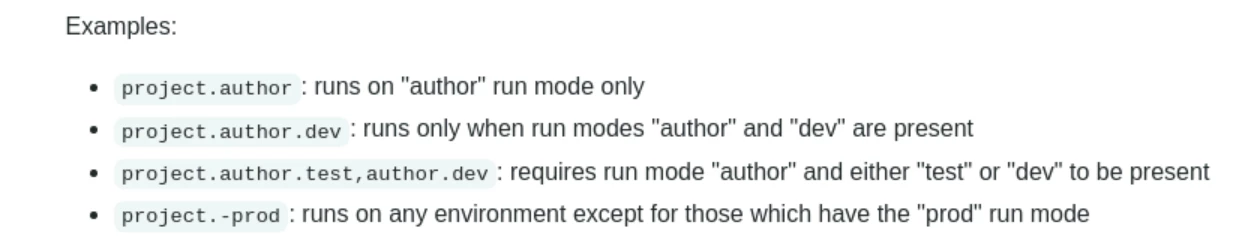

I read ac-tool document but according to this I am not seeing any issue in the runmode-

Is that local depicts your custom run mode? It is working with testuser.publish becauseas we know
Every run mode tries to find out the best possible match available for configuration.
If multiple configurations for the same PID are applicable, the configuration with the highest number of matching run modes is applied.
coming back to your question, try setting custom runmode and check
https://experienceleague.adobe.com/docs/experience-manager-65/deploying/configuring/configure-runmod....
