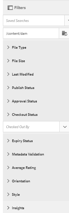

Hi
Go to "localhost:4502/assets.html/content/dam" and click on Box icon on right hand side below the header -> click on Filters
On right hand side new tab would come up. Select publish status -> Unpublished , this will show all the un-published assets in the instance.
There are loads of filters that you can use.
I hope this would help you.
~kautuk
