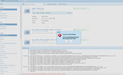

unable to upload and install packages getting blob equality check as error
  • December 29, 2023
  • 655 views

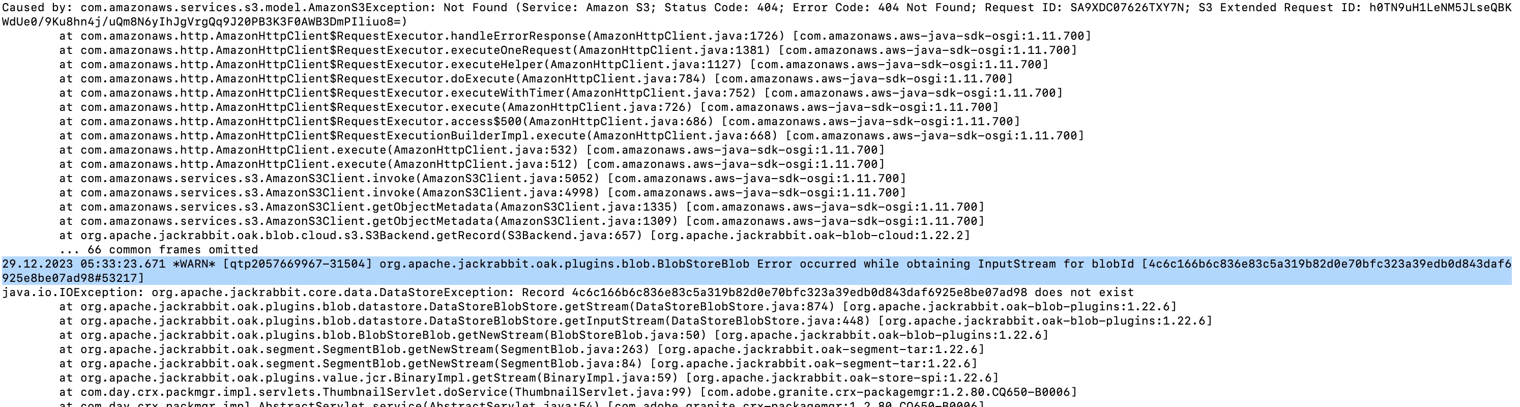

we created a new server for our AEM instance. in that instance when I'm trying to install any package im getting this error. any suggestions on how to fix it?(we don't have CRX-quickstart used s3 bucket and the instance came as an AMI image) below attaching the error

Thanks for mentioning that you are using an s3 bucket, this error is probably due to the network restrictions as in a firewall or any such policies.
I remember a solution to this, can you please check this answer in this post?
https://experienceleaguecommunities.adobe.com/t5/adobe-experience-manager/request-failed-org-apache-jackrabbit-vault-packaging/td-p/560326
