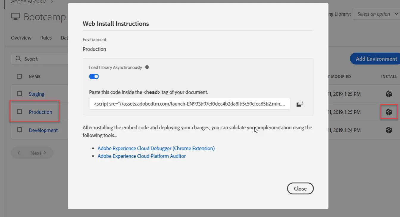

Yes, it's possible to complete:
1. From the Launch property, you've been working in, click the Environments nav element
2. Click the Install icon for the Production environment to trigger the Web Install Instructions dialog box:
3. Click the Copy icon to copy the embed code to the clipboard.
4. Add the Launch header code to a page template. For example, for the We.Retail site:
a. browse to /apps/weretail/components/structure
b. place the Launch embed code that you just copied to the bottom of the customheaderlibs.html file:
