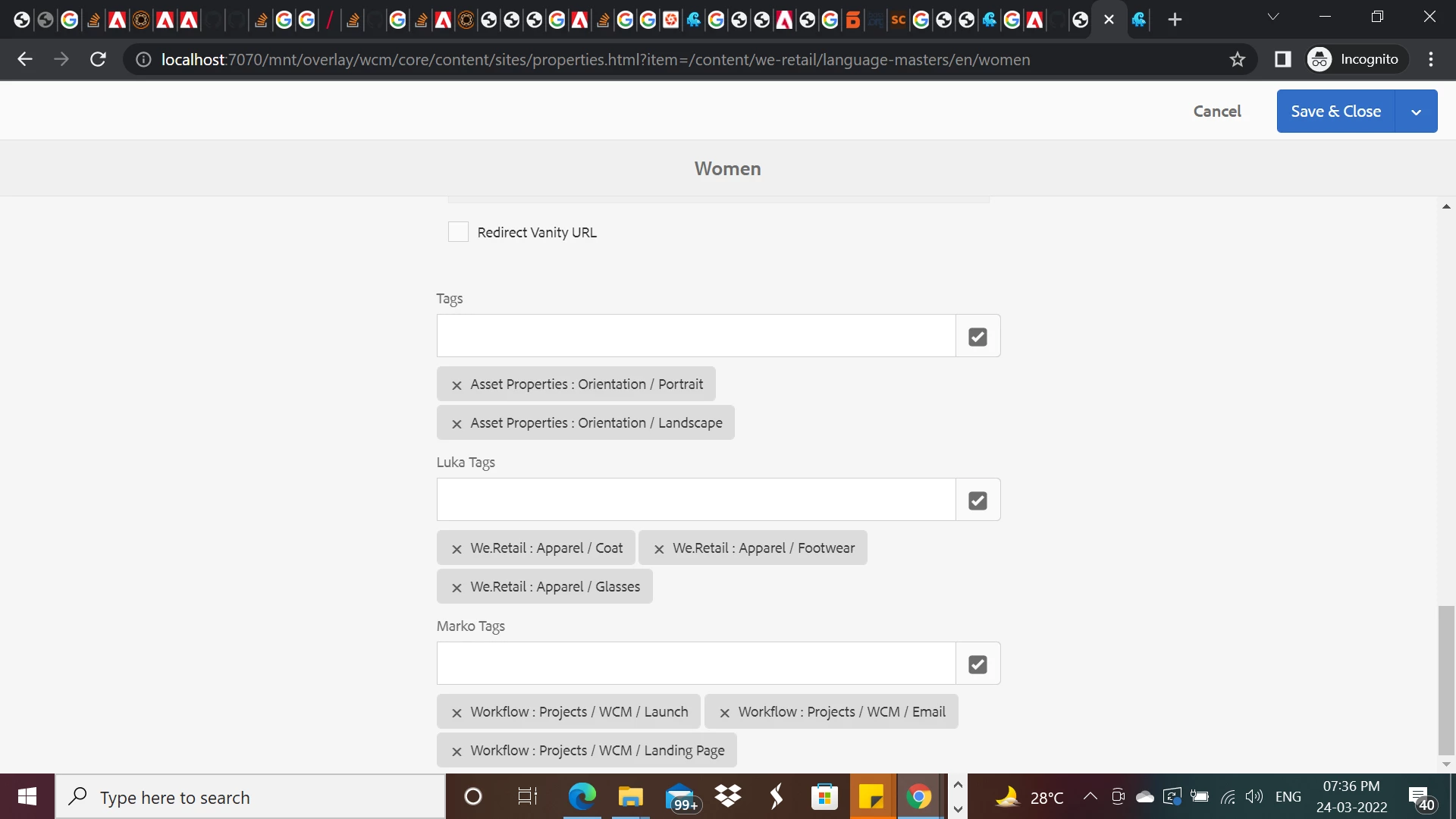

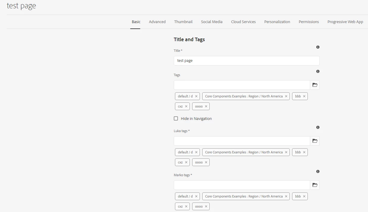

I have a requirement to add two additional tag fields in page properties below original tags field.(i am using cq/gui/components/coral/common/form/tagfield). As you can see from the picture there are two additional fields, Luka tags and Marko tags. They are both mandatory and both have their defined namespaces(Luka namespace and Marko namespace).
The problems i am encountering are as follows:
1. When i save tag that was manually entered  or selected from a tag from a specific namespace, it saves the tag under "default" namespace but i want it to save the tag under  "Luka namespace" if the tag was entered in "Luka tags" field. If the tag is entered in "Marko tags" then i want it saved under "Marko namespace". Is there a way to do this using properties in CRXDE? If not, how would i achieve this?
2. The other problem i'm having is that if you look at the picture, every field that is related to tags has the same tags list. I want every tag field to have its own taglist depending on where the tag was created. For example, if the tag was created using "Marko tags" field than i would like to display that particular tag to the taglist that is below "Marko tags" field. The current behaviour is that whenever i add  tags and click save&done, the next time i open page properties, every taglist under every tags field is the same(as showed in picture). How can i create separate tag list for every tags fields?

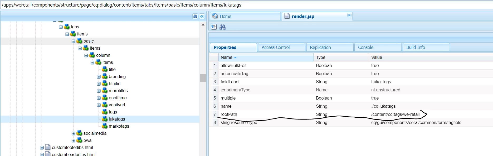

I feel those tag fields are part of your page component [we used to call it project specific base page component].
If we take a look at CRXDE to understand the details about those tag field then we will get similar kind of details as shown below -

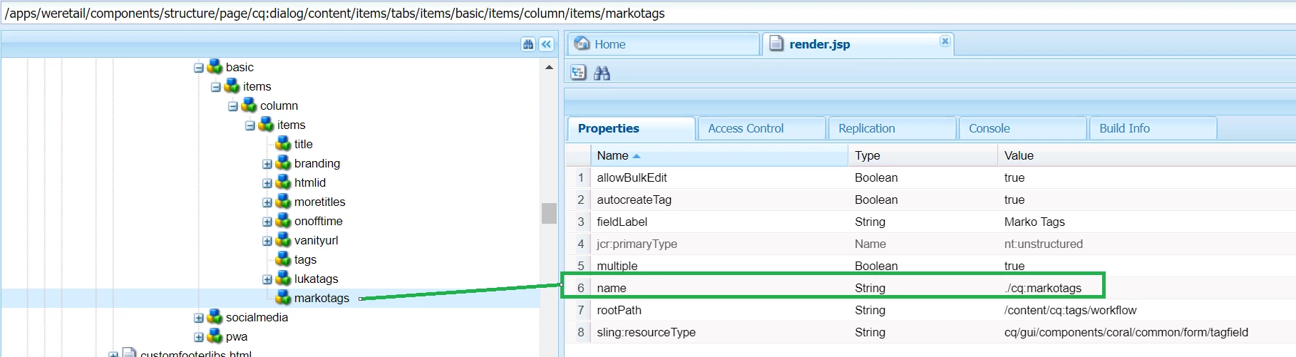

I have created 3 separate tag fields to replicate your requirement as shown below -

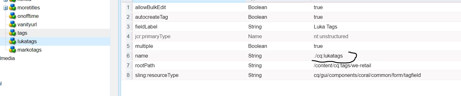

Here , we must have unique value for property: name for each tag fields as shown below -
I feel you are having same value at property called: name for each tag field. That's why you are facing 1st problem.
To address the 2nd issue , you could fix the problem using rootPath with different taglist value as shown below -

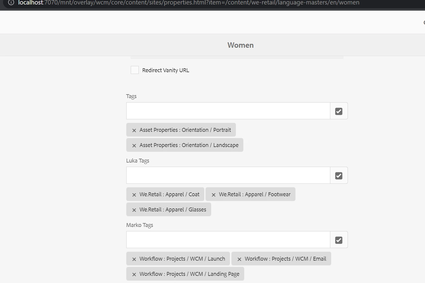

DEBAL_DAS_5-1648131580526.pngDEBAL_DAS_6-1648131630756.pngDEBAL_DAS_7-1648131667486.png
Because of the different rootPath value finally I am able to display different set of tags for each tag field -

2. I think the issue here is for all the three tag fields the 'name' property seems to be the same. For the default/OOTB tag field, the 'name' usually will be 'cq:tags'. Please provide different name property for 'Luka tags' and 'Marko tags'. The name can be anything like lukeTags, markoTags etc. Please do this change and check whether it resolves your first issue as well.

What you said does solve my second issue(because name properties were the same) but the issue number one still persists, for example when i want to save the "savedtag" (like in the picture below)showcase4.PNG
Then i am expecting for that tag to get saved in AEM tags>Luka tags
My namespace folder Luka tags stays empty.
