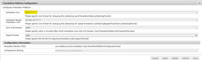

There is one configuration by name "Translation Platform Configuration" where we can give cron expression for changing the scheduling (syncTranslationState.schedulingFormat). we have set it to run for every 5 minutes. Even this didn't help. PFB screenshot for the configuration.
