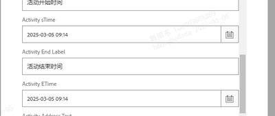

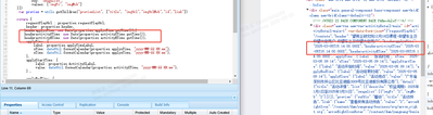

我将再次使用 datepicker 在对话框中配置时间。但是我使用了标头 applysTime: 打印出新的 Date (properties.applysTime 的getTime()),并且 “headerpapplysTime”: “2025-03-05T15:14:00.000Z” 比我配置的要长 6 小时。我的配置如下

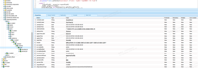

In the JCR node, the+8 time zone is displayed. What I don't quite understand is why I added 6 to the 09:14 time after outputting it, which turned it into 15:14

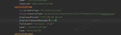

Try to add a Z at the end of you displayFormat property definition. Something like this:
displatFormat="YYYY-MM-DD HH:mm Z"
This should just be about the display format of time! It has nothing to do with the time I configured and the time obtained through the new date, right! The storage time of JCR node is 2025-03-05T09:14:00.0000+08:00, but I converted the time using new Date (properties. activityTime. getTime()); 2025-03-05T15:14:00.000Z; The difference between these two times is six hours, not eight hours

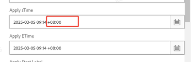

displatformat add Z ;Just added display+8:00 as shown in the above picture
Can you log the value from properties.activitySTime.getTime() to see exactly what is it ?
