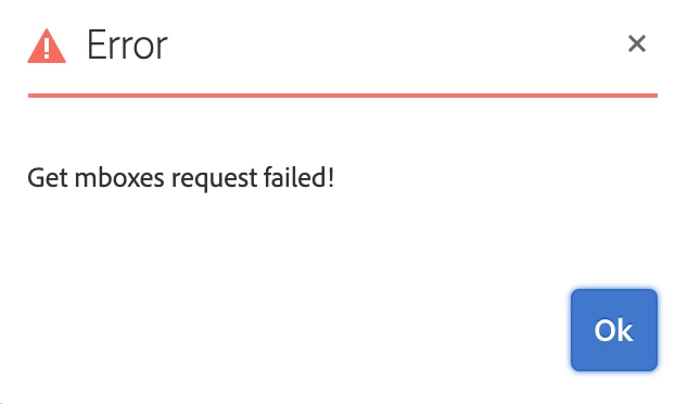

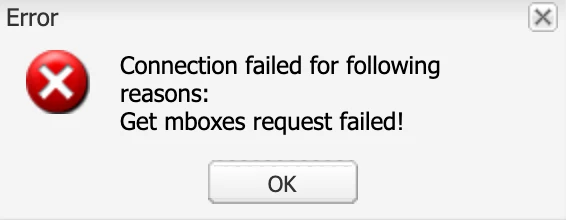

Hi everyone,
I have faced a challenge to integrate Adobe Target with AEM 6.5 via IMS. The IMS has been configured, the status is OK (Token retrieved successfully). However, when integrating Target either via "AEM Cloud Services Opt-In" dialog or via Cloud Services configuration an error message "Get mboxes request failed!" pops up.
Does anyone know the cause of this error?

May 21, 2019
Setting up a DEBUG logger on the following classes should provide more details about the failure.
com.day.cq.personalization
com.day.cq.analytics.testandtarget

Amuthesan
May 31, 2019
Hi Andrey,
I ran in to the same error as you during my attempt at integration. While I trigger the health check AEM connects to Adobe IO to get mbox list. Please check the logs there should be clear information on to why it is failing for you.
If it helps, the error that I ran into,
From the logs I came to know that AEM was trying to connect to the Adobe IO via url,
https://mc.adobe.io/<clientcode>.experiencecloud/target/mboxes
Since the client code was incorrect it failed with message,
{"error_code":"502061","message":"Bad Gateway. No tenant associated with the user profile."}
Updating the client code as per the reference in my previous post, addressed the problem.
