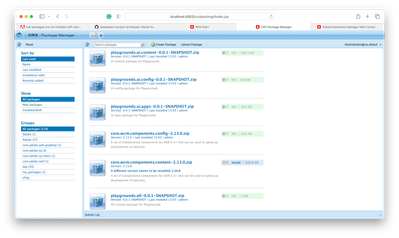

I tried to deploy the updated code to AEM, but the sub-packages are not installed.
If I manually install the sub-packages one by one they are installed correctly, but it is very inefficient.

confirm that mysite.all-0.0.1.zip was unziped and the following sub-packages were installed.
mysite.ui.apps-0.0.1.zip
mysite.ui.config-0.0.1.zip
mysite.ui.content-0.0.1.zip
execute the command below again.
mvn clean install -PautoInstallSinglePackage
you can confirm that sub-packages aren't installed even though mysite.all-0.0.1.zip was unziped.
