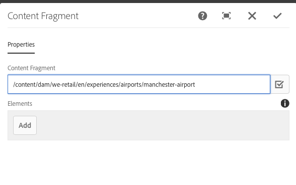

This reference link explains about the use of Structured content in pages. The reference documentation gives following screenshot for using Content Fragment and mentions  "Add any Elements to be displayed or leave empty to show all elements."

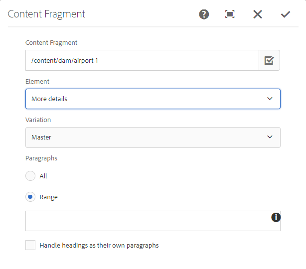

But when we are checking on WCM Core components ver 1.1.0 on local we see following (its not allowing to select multiple elements)
Is this an issue with documentation or configuration?

It seems the screenshots in documentation have been given from we.retail sandbox component. The documentation doesn't mentions about the sandbox content fragment component. After installing we.retail sandbox component the dialog is coming as shown in documentation.
