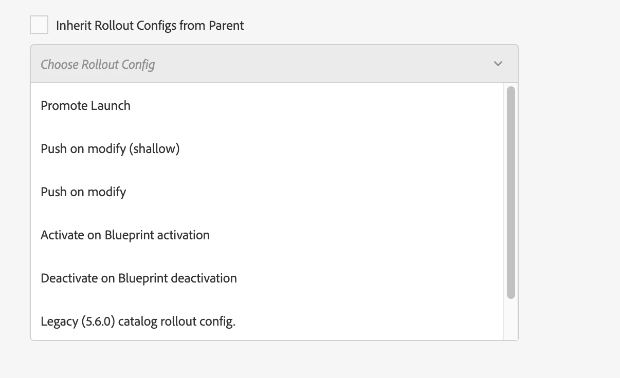

Hello Everyone,
I am facing a weird issue.
The "Standard rollout config" option is missing from "choose rollout config" dropdown in Live Copy tab on PROD environment. But is it available in all other environments (DEV, STAGE). We are using AEM 6.5.6.
Do I need to contact Adobe about it as the PROD environment is directly setup by them ?
Thanks in advance,
Dipti_Chauhan

Hi @harsingh91
  May be this configuration is deleted by mistake on Production .
you can check these rolloutconfigs at /libs/msm/wcm/rolloutconfigs
thanks
dipti
harsingh91
July 12, 2021
Thanks @dipti_chauhan  for your quick response. Yes it is available under the /libs/msm/wcm/rolloutconfigs, but not in the dropdown
What can be the reason for it and should I contact Adobe about it ?
ChitraMadan
July 12, 2021
Hi @harsingh91 ,
Standard Rollout Configuration corresponds to this node - /libs/msm/wcm/rolloutconfigs/default
Please make sure, this node exists in your production environment.
If the node is present and still you are not able to see it in the dropdown, then other option you can try is to set this configuration as the default one:
Setting the System Default Rollout Configuration
Specify a rollout configuration to use as the sytem default. To specify the default, configure the OSGi service:
  • Day CQ WCM Live Relationship Manager
    the service PID is com.day.cq.wcm.msm.impl.LiveRelationshipManagerImpl
Create the live copy, do not give any rollout config and see page properties Live Copy tab, you should be able to see this:
Hope this helps!!
Chitra
harsingh91
July 13, 2021
Thanks @chitramadan for your answer.
Yes, the node exists in production environment.
Unfortunately, I don't have access to system/console on PROD, so need to ask Adobe about it to check if the Day CQ WCM Live Relationship Manager is setup correctly.
My first assumption would be the configuration has setup correctly, as it is managed by Adobe directly. But I will check with them and come back to you , if it didn't work after that.
