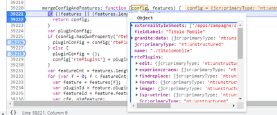

Debugging the js /libs/clientlibs/granite/richtext.js we notice that at line 39223 in case B, the config variable is not resolved, below are the screens for cases A, C, D, and for case B
Test case B
Test case A,C,D
Does anyone have any idea how to fix this? Seems that the config object does not resolve sling:resourceSuperType within a  granite/ui/components/coral/foundation/include.
