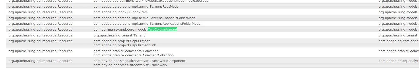

Edit: If I go to /system/console/adapters, I can see the sling models registered on my 6.1 server but not in 6.3

By the way - in the article - if you install the package - you will see it registered as shown here:
Build 6.3 Models the way we describe in the Article: Using Maven 11 Archetype.
NOTE - i updated the article to mention this UI as per your comment here.
