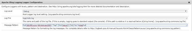

I am trying configure SL4J MDC log but the logger is not printing in pattern given in the logger configuration .
Bellow are the steps followed.
1. created one logger configuration as shown in attached diagram with pattern  "%d{dd.MM.yyyy HH:mm:ss.SSS} *%p* [%X{req.q}] [%t] %c %msg%n".

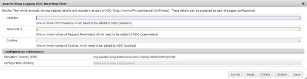

2. In the Apache sling logging configuration added the parameter as "q".

4. We are hitting the Servlet with parameter q="something". Logger.debug not printing in the mdc log format ,even if we are removing time stampmdcfilter.jpgslingloggerconfig.jpg from the pattern it is always printing in the same format as
23.05.2018 16:24:54.581 *DEBUG* [0:0:0:0:0:0:0:1 [1527072894580] GET /bin/cookie/set HTTP/1.1] com.mattel.ag.core.servlets.CookieAddingServlet Querry parameter is q=Sinha1

A bit late reply but found out during my own debug session.
You need to set up the filter ranking higher. You can do it using either osgi repository based configuration or setup your own mdc filter. This happens when mdc filter is not called up in the hierarchy of filters so setup it's ranking high enough.
This resolved problem for me and my mdc pattern logs started firing up
