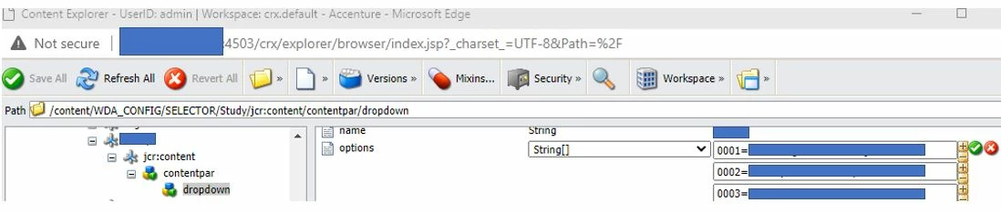

Hi all,
I am trying to update the below dropdown's list. Since there are a lot of items, it takes time to add the items by using '+' icon button and remove by using '-' icon button as well. Is there any shortcut way to upload in one shot?
