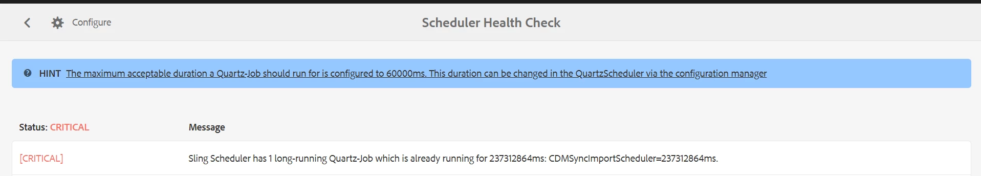

We have created Scheduler called CDMImportScheduler in AEM6.5.CDMImportScheduler is not getting triggered now. We are seeing in CDMImportScheduler is running very long in "Scheduler Health Check ".

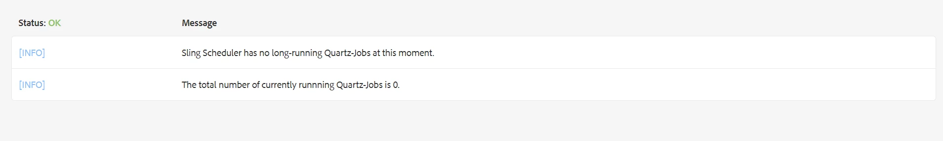

After doing soft restart from webconsole i am not seeing CDMImportScheduler in Health checks. Health check is normal but scheduler is not still running. How to handle and resolve this issue.

Hi @ganag
The issue could be due to the long running scheduler.
I would suggest to move your logic from scheduler to a sling job

Hi @ganag
January 8, 2024
Hi @ganag
This seems to be an issue in the business logic of your scheduler. Could you just remove all the logic and just test in your local with some logger and check if the scheduler is working?
