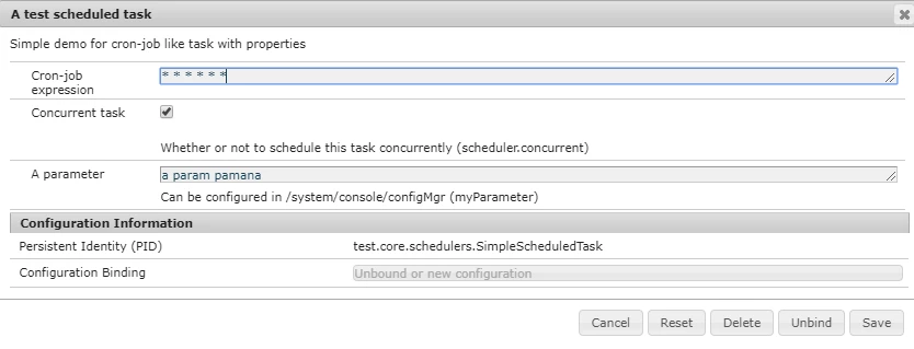

Using AEM 6.5, I'm trying to create a Scheduler, similar to this: Adobe Experience Manager Help | Scheduling Adobe Experience Manager Jobs using Apache Sling
But these linked instructions appear to not work with 6.5.
So instead, I'm basing my scheduler off the archetype 19 available here: https://github.com/adobe/aem-project-archetype , however, I'm still having issues.
To create a new bundle, I run:
mvn archetype:generate -DarchetypeGroupId="com.adobe.granite.archetypes" -DarchetypeArtifactId=aem-project-archetype -DarchetypeVersion=19
Then I add some logs to the SimpleScheduledTask.java that is created:
package test.core.schedulers;
import org.osgi.service.component.annotations.Activate;
import org.osgi.service.component.annotations.Component;
import org.osgi.service.metatype.annotations.AttributeDefinition;
import org.osgi.service.metatype.annotations.Designate;
import org.osgi.service.metatype.annotations.ObjectClassDefinition;
import org.slf4j.Logger;
import org.slf4j.LoggerFactory;
* A simple demo for cron-job like tasks that get executed regularly.
* It also demonstrates how property values can be set. Users can
* set the property values in /system/console/configMgr
@Designate(ocd=SimpleScheduledTask.Config.class)
@Component(service=Runnable.class)
public class SimpleScheduledTask implements Runnable {
    @ObjectClassDefinition(name="A test scheduled task",
                           description = "Simple demo for cron-job like task with properties")
    public static @interface Config {
        @AttributeDefinition(name = "Cron-job expression")
        String scheduler_expression() default "*/30 * * * * ?";
        @AttributeDefinition(name = "Concurrent task",
                             description = "Whether or not to schedule this task concurrently")
        boolean scheduler_concurrent() default false;
        @AttributeDefinition(name = "A parameter",
                             description = "Can be configured in /system/console/configMgr")
        String myParameter() default "";
    private final Logger logger = LoggerFactory.getLogger(getClass());
    private String myParameter;
    @Override
    public void run() {
        System.out.println("running");
        logger.debug("SimpleScheduledTask is now running, myParameter='{}'", myParameter);
    @Activate
    protected void activate(final Config config) {
        System.out.println("activating");
        myParameter = config.myParameter();
Then I install this bundle using
mvn clean install -PautoInstallBundle
So now my bundle is installed:
And my service is configured:
And my stdout.log has the  "activating" log from the code, but I'm never seeing any "running" logs, nor am I seeing any evidence of errors in the error.log
So it appears to me that the archetype sample Schedule simply doesn't work out of the box (OOTB), unless I'm missing something.
How can I get this to work?

Best answer by grantc99475970
I compared your files with mine, and see no major differences. I updated a few plugin/dependency versions, but that didn't seem to help.
My issue is that the plugin activates, but the run function is never hit. Does yours run?
EDIT: Oh, I think it has to do with my cron-expression. I was using " * * * * * * " and never saw it run. Then I changed it to "0 * * * * ?" and then I saw it running. I guess I didn't understand how cron expressions work.
arunpatidar
August 6, 2019
grantc99475970AuthorAccepted solution
August 6, 2019
