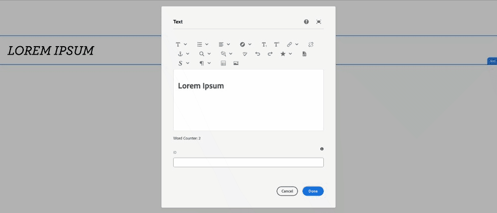

In RTE, I am trying to justify content using the justify plugin. In the below gif, you can see that content gets aligned in RTE, but after dialog submission text alignment does not work.
However, the same code and RTE work fine in my local environment. It shows an error in the console whenever I click on the justify plugin.

Hi @mayursatav ,
After dialog submit, just try inspecting the HTML through browser element, do you see the style text-align:center added to the text? If yes, then it might be because of some other design/CSS overriding the center alignment.

That i already checked only empty style attribute is coming. But you can see under xdm:text that inline style for text align is appearing.
Sharing DOM with you.
<div class="cmp-text" data-cmp-data-layer="{"text-ad3342e4f1":{"@type":"aem-mysite-base/components/content/text","repo:modifyDate":"2023-02-11T09:29:54Z","xdm:text":"<h1 style=\"text-align: center;\">Lorem Ipsum</h1>\r\n"}}" id="text-ad3342e4f1"> <h1 style>Lorem Ipsum</h1> </div>
