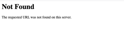

As well if I bypass the dispatcher by accessing the publish url:
https://publish-pXXXXX-eXXXXX.adobeaemcloud.com/content/dam/robots/<sitename>/en_gb/robots.txt
It still gives a 404
