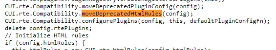

but it seems that the replacement is random (not stable). sometime it's work and sometime no. debugging the clientlibs: /libs/clientlibs/granite/richtext.js i saw the "deprecated" word:

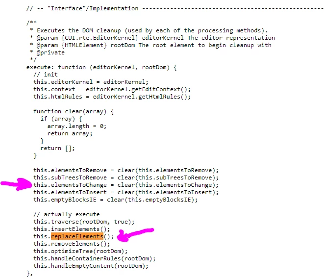

and during the
this.elementsToChange = clear(this.elementsToChange);
the list sometime is 0 and other time is correctly catched!
What i'm wrong? my suspect is related to the "<strong>" tag acceptance.. seems that from this customization the tag is replaced and from another side, the tag is converted againt into <b>.
