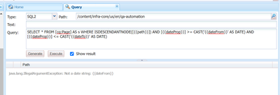

Hi @skumari1
Can you try running the Report Query in CRX and see if the results are coming fine?
Also check configuration of Query Language value that is configured as part of JCR Query Report Configuration component. Check if it same as the intended value. Refer below document to check the same
https://adobe-consulting-services.github.io/acs-aem-commons/features/report-builder/configuring.html
Hi @ksh_ingole7
The result after running it from crxde
There seems to be an issue with the Query. The query is not able to generate results hence not able to return it to the Report. If we fix the query the report should ideally work.
I believe you are trying to fetch pages between 2 dates based on 'DateProp'. 'dateFrom' and 'dateTo' are provided in the report.
I ran the below query and it fetched the results between specified dates.
SELECT p.* FROM [nt:base] AS p WHERE ISDESCENDANTNODE(p,'/content') AND (p.[cq:lastModified] >= CAST('2022-01-01T00:00:00.000Z' AS DATE) AND p.[cq:lastModified] <= CAST('2022-12-31T23:59:59.999Z' AS DATE))

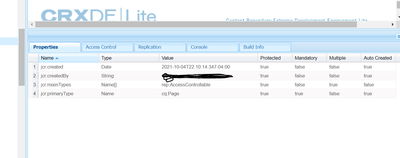

1. Check if the dateProp, dateFrom, dateTo properties are getting fetched into the Report.
2. Is the 'dateProp' present on cq:Page node or nt:base node?
Hi @ksh_ingole7
Are you asking about the below window whether dateProp present here as a property or not?

The error which i am getting in the error.log console its only saying about  date format. So i have tried to modify the date format, currently using "yyyy-MM-dd'T'HH:mm:ssZ". You can also see in the image.
javax.jcr.query.InvalidQueryException: java.lang.IllegalArgumentException: Not a date string: {{dateFrom}}

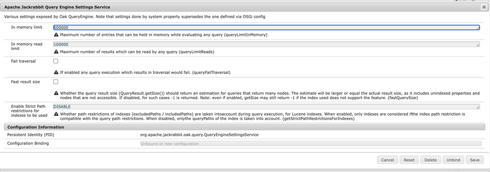

Hi @skumari1, I know this Exception. It's because your Report is calling too many queries. Just increase your in-memory limit at
Query Engine
Apache Jackrabbit Query Engine Settings Service
Aditya Chabuku
Hi @Aditya_Chabuku
Its already 500000, shall i increase this if yes then how much?
Also the error log having these details:-
Caused by: javax.jcr.query.InvalidQueryException: java.lang.IllegalArgumentException: Not a date string: 2022-08-16T00:00:00.000 05:30
Caused by: com.adobe.acs.commons.reports.api.ReportException: Exception executing search results
Caused by: java.lang.IllegalArgumentException: Not a date string: 2022-08-16T00:00:00.000 05:30

Added one zero in the "In memory limit" but it didn't worked. still got the same error.
