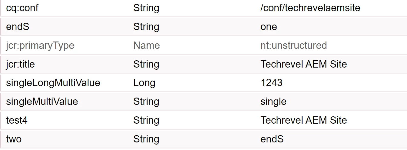

set properties on /endkeyword # using "end" instead of "endS" below causes parsing to fail set endS to one set two to endS end set properties on /forcedMultiValue set singleMultiValue{String[]} to "single" set singleLongMultiValue{Long[]} to 1243 end
The documentation shares 2 ways, in which we can set property.
  • "set endS to one" this give us result
  • set singleMultiValue{String[]} to "single" to a String[]. But, what we are getting is a String.
There is a discrepancy in forcibly using Arrays for a Single value.

The repo-init scripts are meant to work during server start. If you are noticing error, you would need to fix them.
We shouldn't need to remove and put them back in.
- Arre these custom scripts?
- If yes, please share the errors logs.
-Why do we need to alter values with repo-init? (Single->Multi)
For now, we need to make sure, paths are available, before setting ACL or adding property.
The proper jcr:primaryType need to be used for creating nodes, as these can't be altered later
