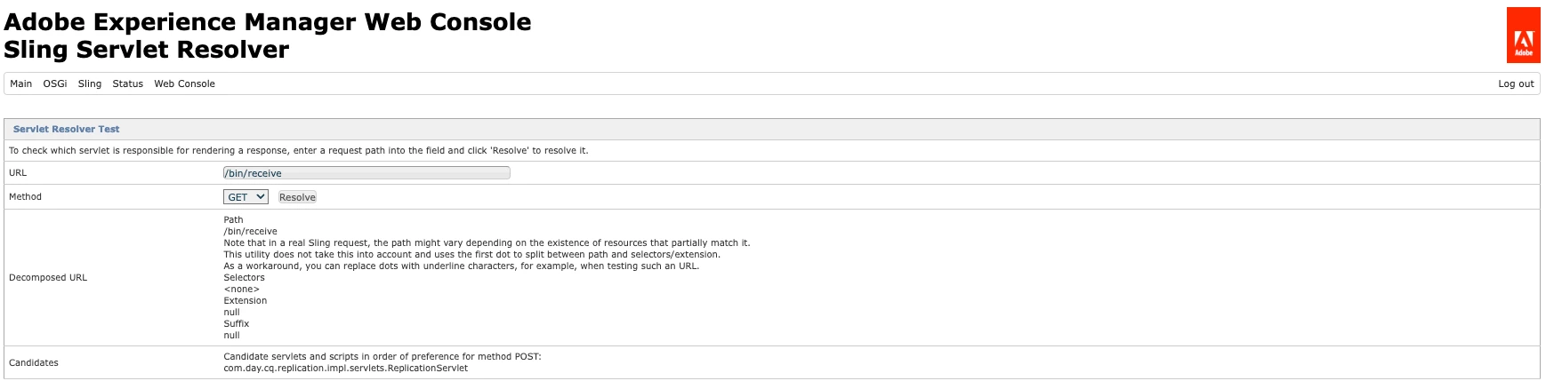

The Sling Servlet Resolver for the /bin/receive POST path seems to resolve normally:
