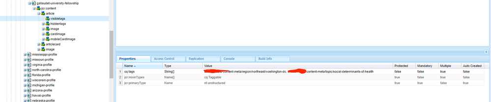

I see the crxde has got the cq: moved property with the new location.Therefore the component shows the new reference in dialog . But however pages are retaining the old tag-id in  repo. And so new search is not doneScreenshot 2023-07-21 at 12.16.43 PM.pngScreenshot 2023-07-21 at 12.19.26 PM.png
Hi @kiran_22_12, Looks like OOTB functionality is not available for Content Tags.
https://experienceleaguecommunities.adobe.com/t5/adobe-experience-manager/for-dam-asset-cq-tags-prop...
Mahedi Sabuj
MS-29LinkedIn
Yess, then I would have to script out the solution.
