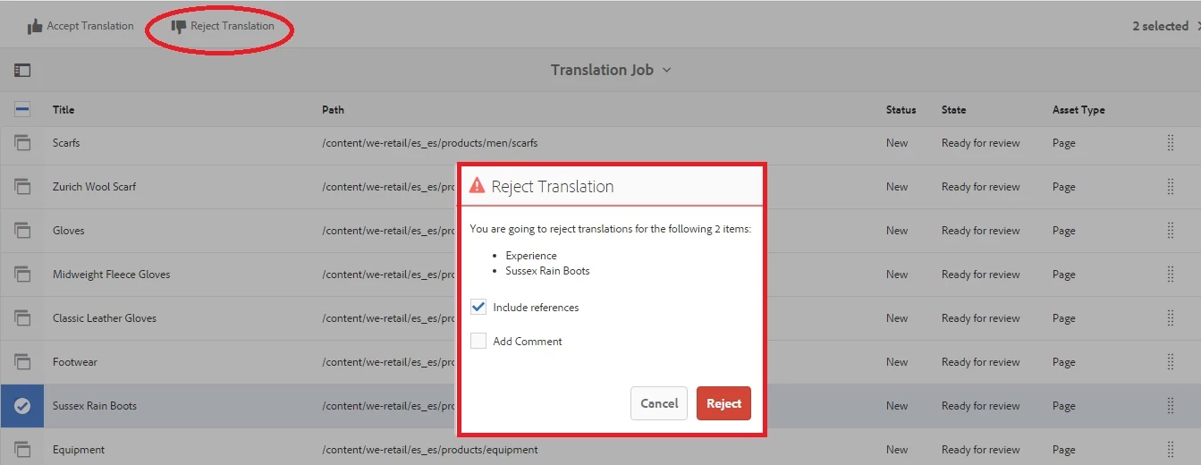

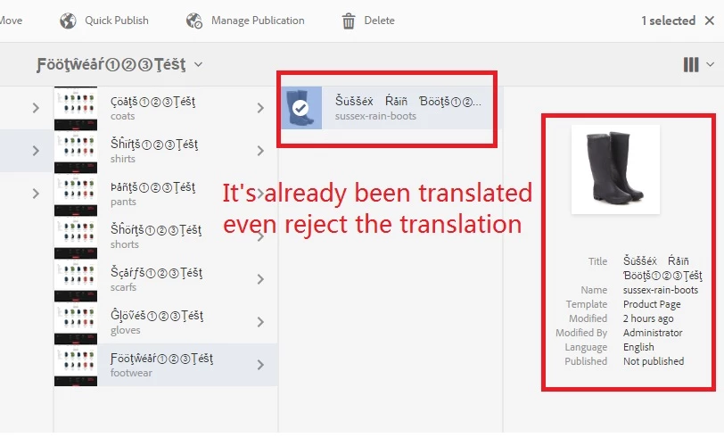

I am using bootstrap connector to test Pseudo Translation functionality. If I totally have 7 pages need to be translated, 6 of them are approved translation, 1 of them is rejected, however I still can see the page is still be translated even though I reject this page in Translation Job. I also checked the JS code of accepttranslation.js and rejecttranslation.js are pretty similiar, so I assume reject translation functions is the same as accept translation which means reject translation doesn't work.
I also tested Microsoft Translation Connector, the behavior is the same.
So does anyone know why reject translation doesn't work? Is this the AEM bug and any solutions to resolve this problem?
Please refer to attachment for more detail.

Reject functionality would initiate update translations, if supported by translation partner. Once a user rejects translation objects, translation partner will be notified with the same. If you are working with a partner, please request your translation partner regarding the support for reject workflow. If you are building your own connector or a partner, this process is initiated via updateTranslationObjectState[1].
Also, as this needs reading comments and updating translations accordingly, it is not supported by Machine Translation only frameworks like Microsoft.
Reject status is an indication that the content needs update. The content would not be reverted to source language.

Thank you smacdonald2008 for your reply. BTW: Can you let me know where I can find the source code of Accpet Translation and Reject Translation step?
Please check screenshot if I find the right one?
