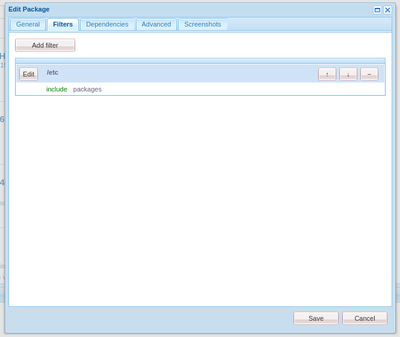

We tried taking a package from Publisher instance, getting error like " package can not create for itself" while building and is there any reason why this got deleted.? ever experienced.?
Try to do the following: select /etc as root and include packages
Let me know if that works..
Great.! Thank you it worked fine, but in publisher we have 246 packages all together, but here after installing this package, we received only 75 packages. how can we get all? and still we are not able to do the deployments.

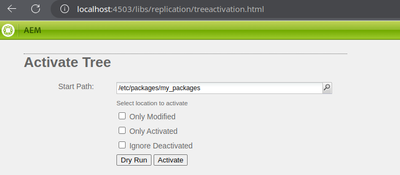

It worked for me. However, you can still try activating your required packages from the activation tree (from publish)
See if this one serves your need..
Sorry.! this doesn't work.
