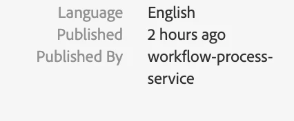

Hi guys, may I know what is this workflow-process-service? Whenever I tried to publish a content page via a custom workflow (contains approvers step) and when it gets approved, it is published by the workflow-process-service instead of the approver. Do anyone have any idea about this?

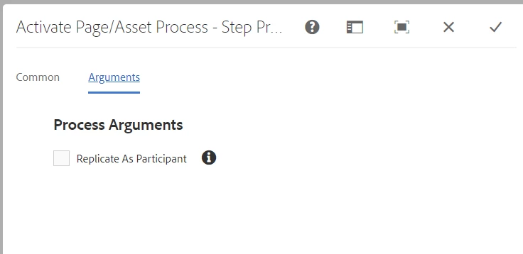

Best answer by arunpatidar
You can change it from Activate Page/Asset Process Step dialog.

The session passed to the WorkflowProcess is backed by the service user for the workflow process service,
Please check document : https://helpx.adobe.com/in/experience-manager/6-2/sites/developing/using/wf-process-ref.html
