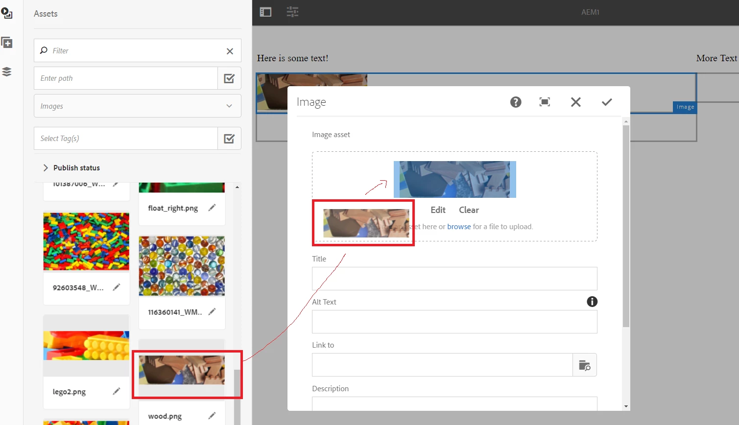

When you have a dialog in the Touch UI that involves images - you are using this type:
FileUpload — Granite UI 1.0 documentation
This requires an author to select a file to upload. For example - dragging from the Content Finder.
THis is the out of the box functionality. Looking at the reference - there do not seem to be a default image field.

June 2, 2017
Now having explained the way the OOTB functionality works - you can create a custom Sling Resource type to address your needs. With the Touch UI, you can develop a custom sling resource type using JQuery plugins. You could use something like this for picking images:
Image Picker
To learn how to build custom sling resource types for a Touch UI component dialog - see this where we use a color picker as an example -- Scott's Digital Community: Creating a custom Experience Manager sling:resourceType for Touch UI
