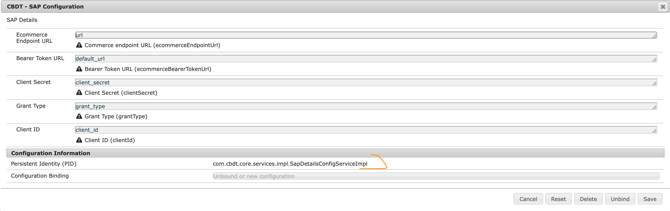

I'm using AEMaaCS. Created an OSGi config with config.author run mode. Deployed it. But while fetching its value, it is coming as null. What can be the issue?
If I'm making any change in crxde config file, it is not getting reflected on OSGi console configuration.
Also, warning signs are coming up against the values in the OSGi console.
I'm working in my local as of now.

2. When your configuration file name is not correct. By default, it must be a full reference to your impl class, in your case I think `com.cbdt.core.services.impl.SapDetailsConfigServiceImpl.cfg.json`
You can copy the correct PID from configMgr:

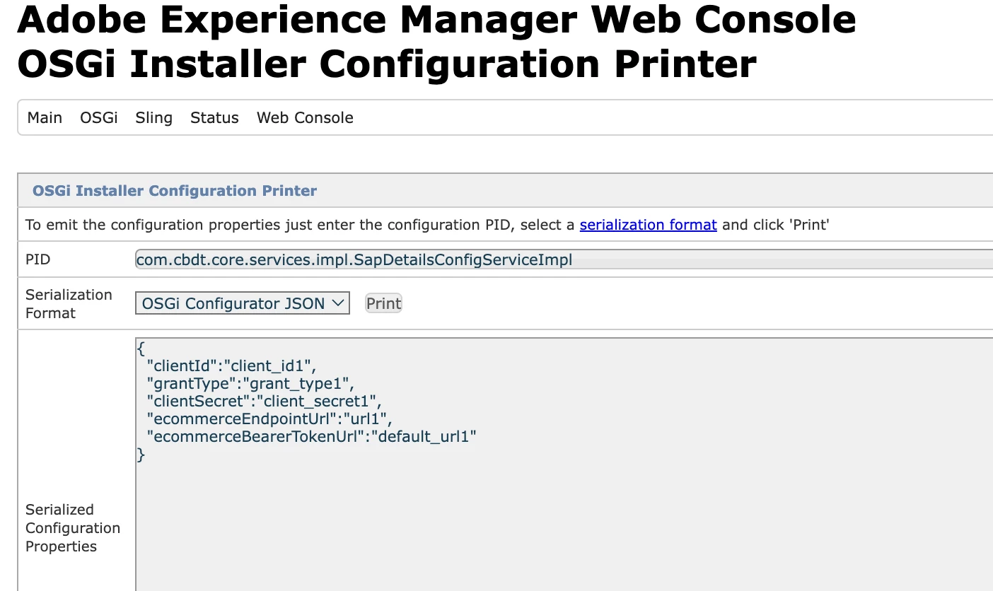

3. If your configuration file is not formatted correctly. To correctly format the configuration it's better to author it using the OSGi Configuration console, and then download the created configuration from your local AEM OSGi > OSGi Installer Configuration Printer (http://localhost:4502/system/console/osgi-installer-config-printer)
Just don't forget to remove the configuration /apps/system/config/com.cbdt.core.services.impl.SapDetailsConfigServiceImpl.cfg.json after you pasted it to your source codes (see #1)
