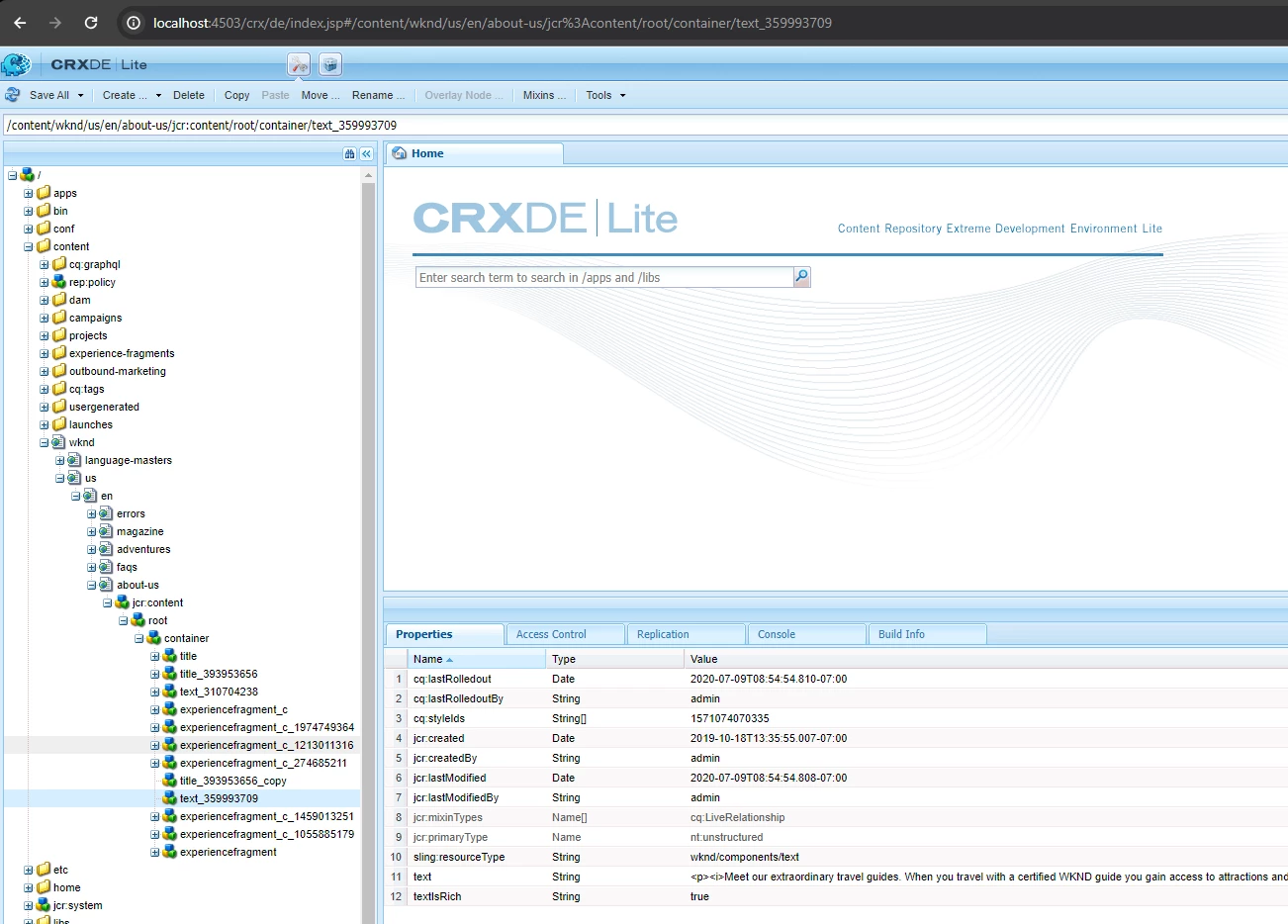

I'm new on the AEM. I'm facing an issue in my local environment, can anyone help on this? Thanks a lot!
I've set local environment and created new AEM project, and installed the AEM WKND Sites, everything is fine, no errors occurred.
But when I tried to visit the page(already published) from publish instance (http://localhost:4503/content/wknd/us/en/about-us.html), it shown nothing on page. I checked the page source, it's nothing. I checked the page in CRXDE, everything looks fine. what's the problem on my AEM?

Hi @aanchal-sikka thanks for your response, I can't find the WKND bundle from 4503 instance, but I can see it in author(4502) instance, below is the details.
btw, I saw another post to ask the same issue, it says to check Sling GET servlet configuration at
http://<host>:<port>/system/console/configMgr/org.apache.sling.servlets.get.DefaultGetServlet
Make sure that Enable JSON and Enable XML are selected.
I checked in 4503 instance, then visit the page http://localhost:4503/content/wknd/us/en/about-us.html, it shows the nodes directly, not the HTML.
I also check the error.log (4503 publish instance), here is the error log details:
03.01.2024 12:08:59.392 *WARN* [[0:0:0:0:0:0:0:1] [1704254939382] GET /content/wknd/us/en/about-us.html HTTP/1.1] com.day.cq.wcm.core.impl.page.PageImpl page at /content/wknd/us/en does not have a jcr:content childresource
03.01.2024 12:08:59.393 *WARN* [[0:0:0:0:0:0:0:1] [1704254939382] GET /content/wknd/us/en/about-us.html HTTP/1.1] com.day.cq.wcm.core.impl.page.PageImpl page at /content/wknd does not have a jcr:content childresource

you're right, that's the root cause. I upload the package and install to publish, it works now.
no need to change the Sling GET servlet configuration of "org.apache.sling.servlets.get.DefaultGetServlet"
thanks!
