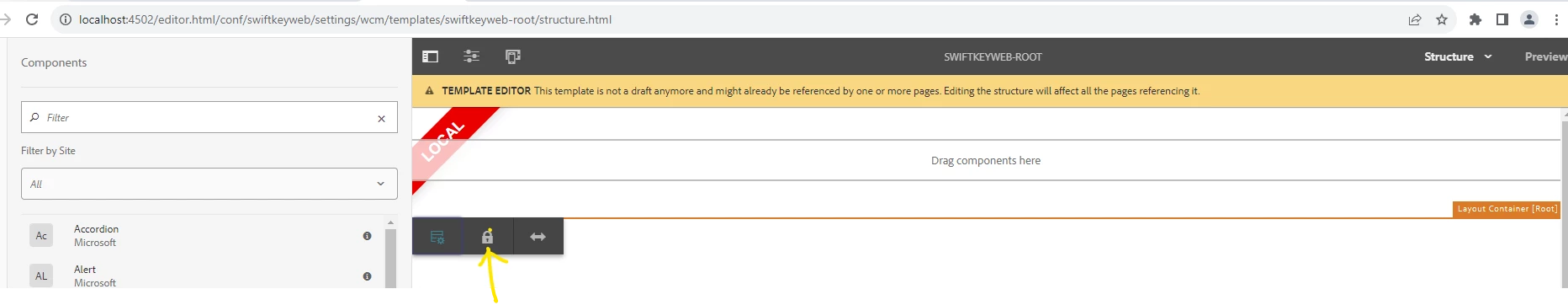

I need to publish templates and template types along with other nodes. I achieve this with a sling job, however, unlock doesn't work on the template root and also on any custom templates created on top of the published template-types.
I notice that, if I pass replicationOptions.setSuppressStatusUpdate(true) it works. But this would not update properties like 'isActivated', 'cq:lastReplicated' and 'cq:lastReplicatedBy' which is a limitation for me.

I agree excluding 'template-types' from publishing would let me unlock, however I have this concern with not publishing 'template-types'
1) They won't exist in publish instance anymore but there is a reference to template-types as shown in this image
Are there any potential issues that could arise if these elements are not included? In the package approach, these elements are present in the published instance. I want to ensure that transitioning to the API approach won’t inadvertently cause any issues.
