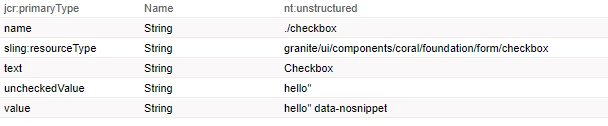

ベストアンサー Anudeep_Garnepudi
Checkbox dialog field should be like
Your HTL should be
<div class="${properties.checkbox @context='unsafe'}>Heading</div>
Important Note: Make sure you don't close the quote after expression i.e quote started after class= and it should not end in HTL as the quote is coming from the dialog properties.
Output:

Approach 2 (Personally don't recommended):
If you srtictly want to use attribute data-nosnippet without any value. Then you need to apply a cheat.
  1. You need an attribute which present always. Here you can take class.
  2. To your dialog checkbox filed value property set value as hello" data-nosnippet
  3. To your dialog checkbox feild uncheckedValue property set value hello"
In HTL
<h1 class="${properties.checkboxName @context='unsafe'}>Heading</h1>
-AG

Anudeep_Garnepudi
October 29, 2021
Your HTL should be
Output:
