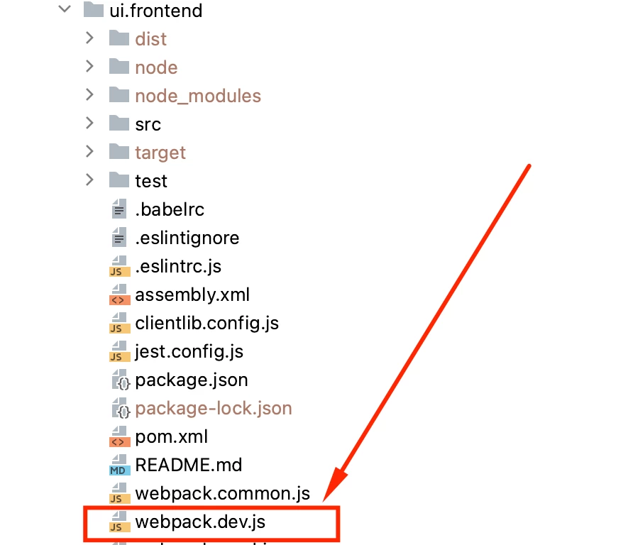

1. Using webpack command
The webpack.dev.js is mentioned in the article you shared. And I image it will be used like this:
"scripts": { "build:microfrontent": "rm -rf ../ui.apps/src/main/content/jcr_root/apps/project/clientlibs/* && webpack -d --env dev --config ./webpack.dev.js && clientlib --verbose", },
For this, your transformation logic will go into webpack.dev.js:
