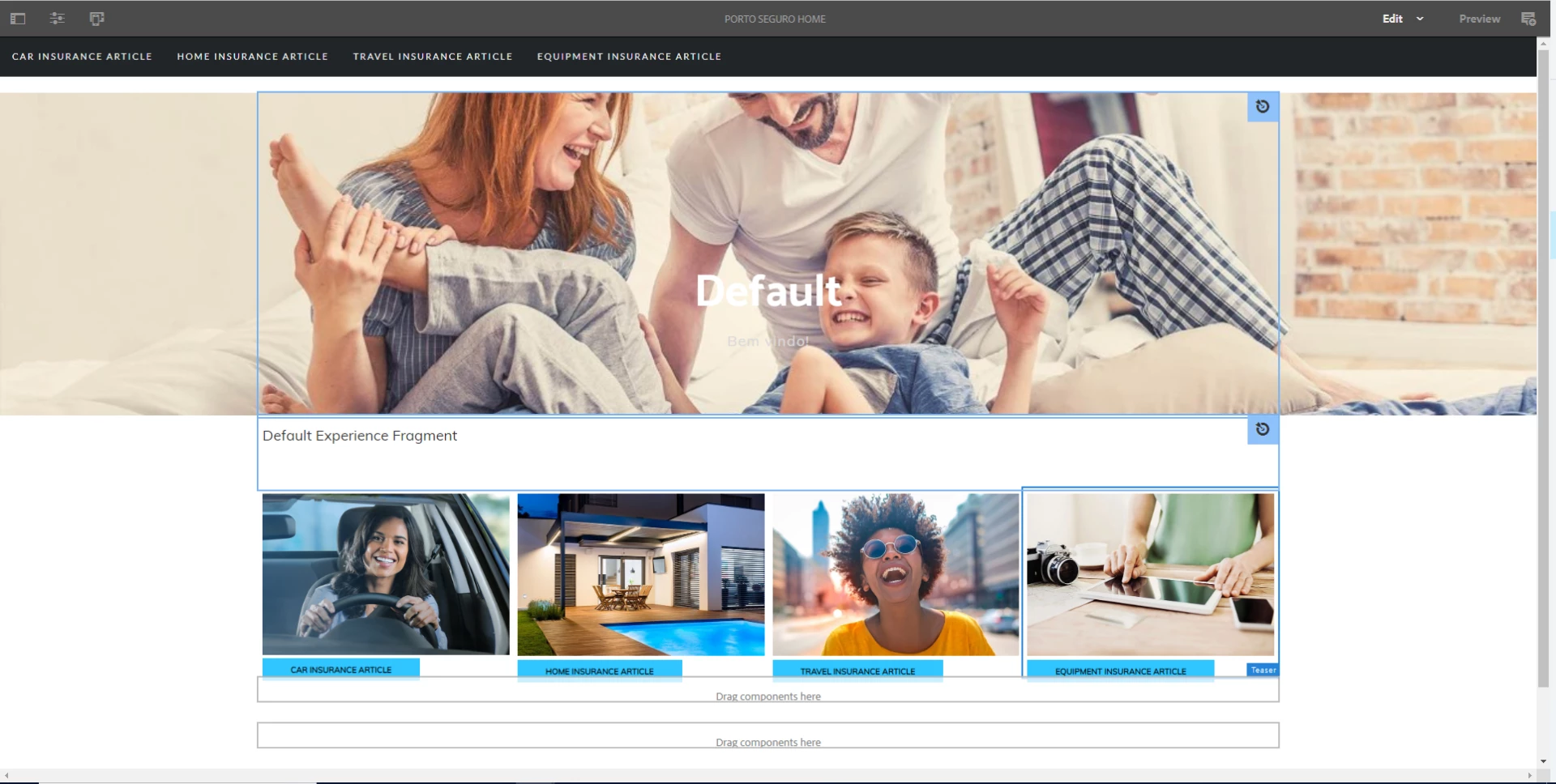

Hello everyone,
When I configure Targeting on a component its content is not being viewed as published. I am using AEM 6.5.
I have an experiment fragment and text component with Targeting set up:
When I see the page as published, it presents the following error:
[AT: Rendering mbox failed target-global-mbox : {status: "error", error: "unknown client code: ifactsolamericasptrsd"}]
This is my client code and I used it in my Cloud Service Target configuration:
Does anyone have a similar problem?
Do you think there is any configuration that I did not do?
