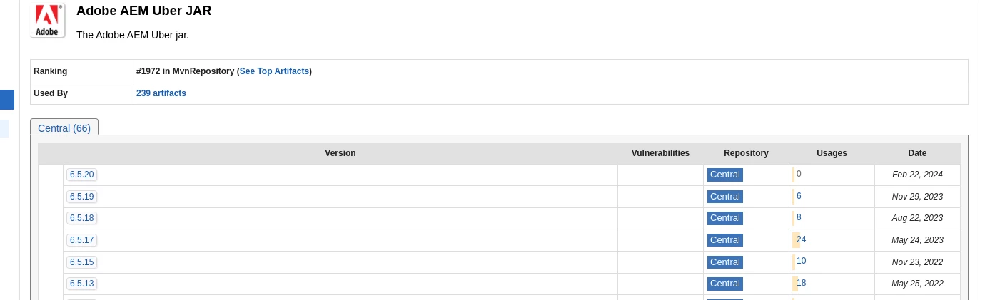

Best answer by abhishekanand_
Hi @meghanapa
You need to use some other version than 6.5.14, the specified version Uber-jar is not available in maven central. try using 6.513 or 6.5.15 instead.

@meghanapa , In your project pom find the below dependency and update the version from 6.5.14 to 6.5.13.
<dependency>
<groupId>com.adobe.aem</groupId>
<artifactId>uber-jar</artifactId>
<version>6.5.14</version> <!-- Uber version update to SP 6.5.13 -->
<scope>provided</scope>
</dependency>
 Hope this helps!!
sravs
April 29, 2024
Hi @meghanapa , there is no dedicated uber-jar with version 6.5.14. Try to use 6.5.13 instead.
Please refer more information here https://experienceleaguecommunities.adobe.com/t5/adobe-experience-manager/when-will-uber-jar-6-5-14-be-available-from-public-maven/m-p/548390

abhishekanand_Community AdvisorAccepted solution
April 29, 2024
Hi @meghanapa
