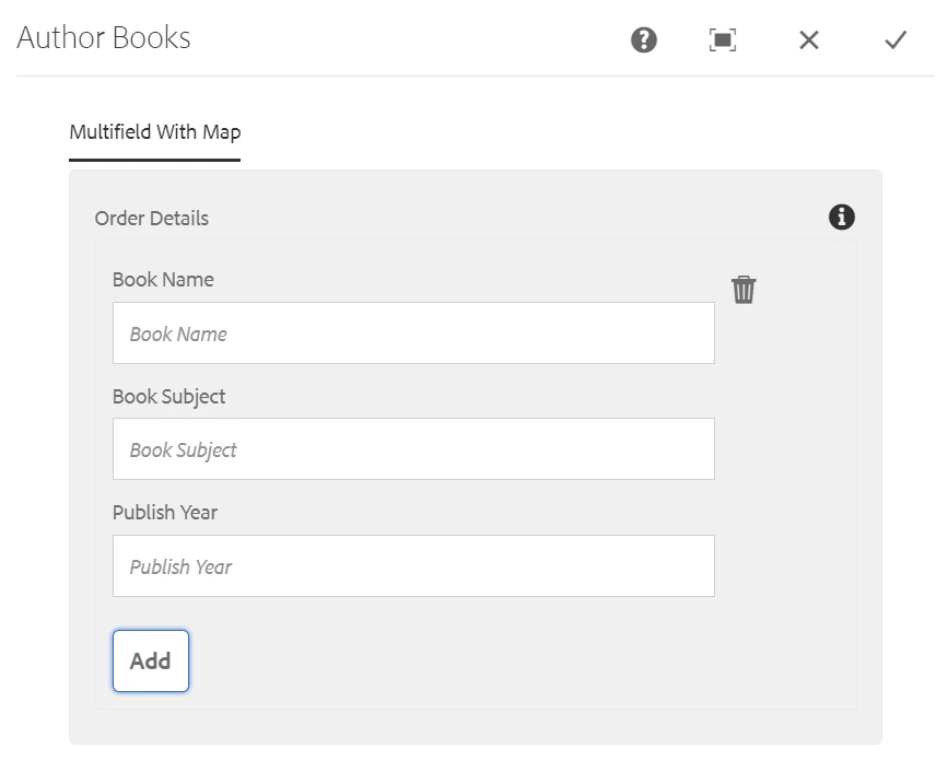

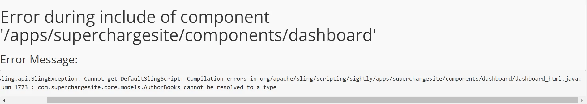

I'm new to AEM. Trying to create one multifield component. But when I'm drag and drop the component through an error. Please Advice what could be the issue.

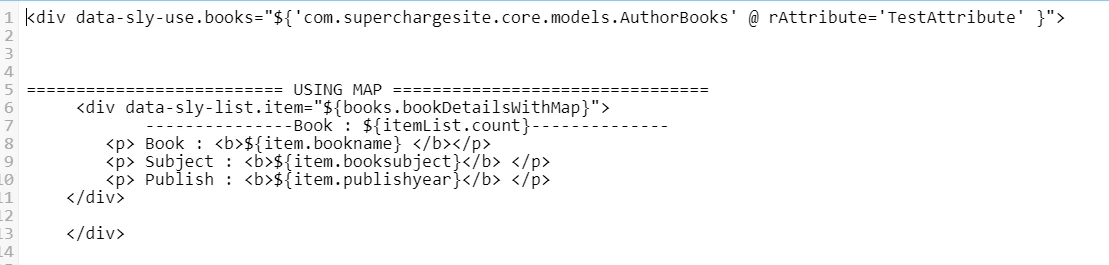

That means your bundle may not be running with the latest version of it due the AuthorBooks model is not present in that bundle, can you try to delete the bundle and redeploy the code?

The error indicates that your Model is not found (resolved), can you please check in the bundles console http://localhost:4502/system/console/bundles if your bundle is in Active state?

@estebanbustamante Yes it is Active.
@estebanbustamante Resolved Thank you ! The same steps i was performed earlier but no luck. This time it got fixed. But wanted to know the root cause.
