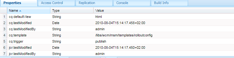

Hi Vishu,
Currently, I am using all the OOTB rollout configs. Not added any of my custom ones. Please find the config screenshot.
The OOTB 'Activate on blueprint activation' is causing the issue. It activates the live copy pages without any publish trigger. I have checked the cq:trigger for 'Activate on blueprint' roll config. It looks correct and mentioned as 'publish'.
Thanks.
According to this, the content from blueprint (Source) will get copied to live copy automatically when there are any modifications in source and livecopy will be activated/deactivated only when the source is activated.
But in your case, the live copy is getting activated without the activation of the blueprint. Is my understanding correct?
yes. you are right. It is not working as expected.
The activation is happening without the activation of the blueprint pages.
