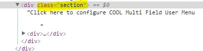

We have been using AEM since CQ 5.4 when a component gets rendered it gets a generated div that wraps the component and in that div it gets some classes like "section". Usually people post to the community asking how to get rid of these. We have the opposite problem, we're trying to figure how to get them back.
We're in the process of upgrading from 6.1 to 6.3. When we upgrade our publish instance it no longer renders the wrapping DIVs and completely messes with the designs that are in place.
Any ideas would be appreciated

What is the exact requirement of having this classes ?

Veena - We have 70+ sites representing over 500k pages that each one is now structurally different. The requirement for having these is so that existing styles, that are managed by a different team, are not screwed up. Now conceivably it may be better at some point to get rid of this wrapping div but we would want to do so in a controlled manner. If I'm unable to determine why they disappeared in the first place I have no level of confidence that they won't re-appear at some point.

I am checking the we.retail demo site (shipped as a sample site , as geometrixx used to be) now. Meanwhile can you send me a mock up of your components HTML as of now. I will let you know what we can do to achieve that
