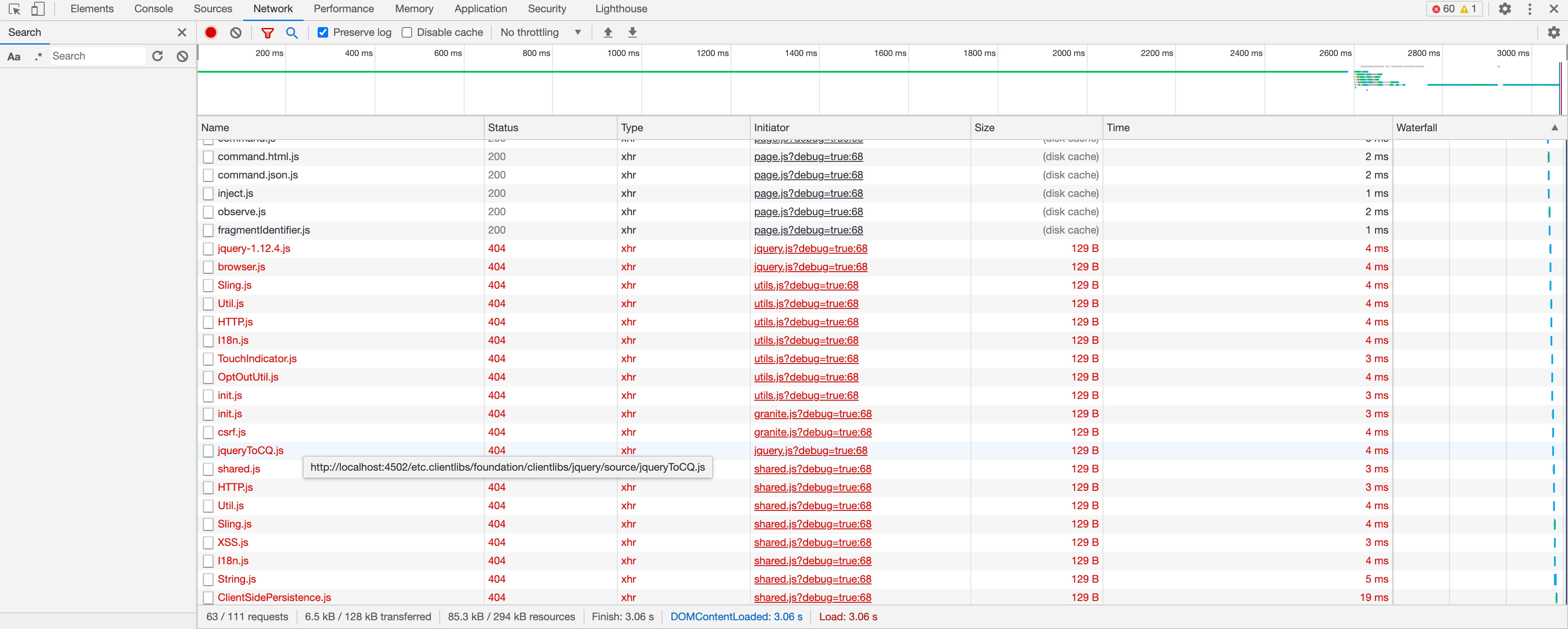

1. Clientlibs are not loading in AEM storefront.

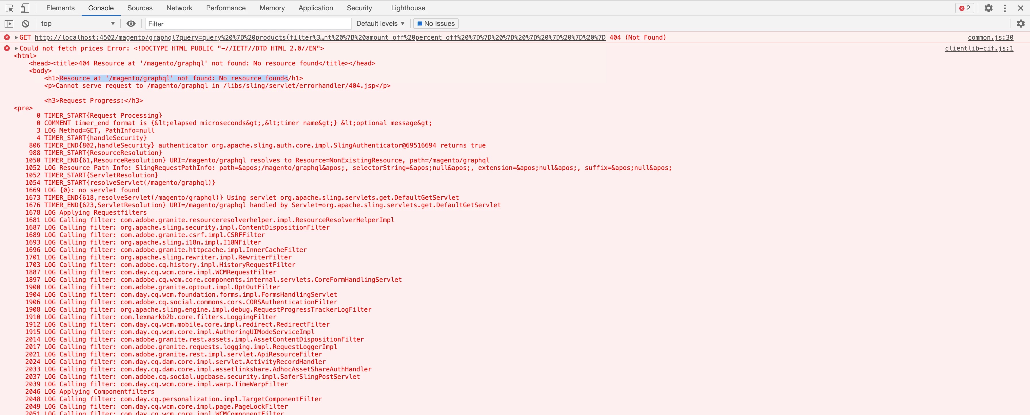

2. Getting error in console :Resource at '/magento/graphql' not found: No resource found.

Hi @anupammaiti ,
I don't think there is a relation between clientlib and /graphql endpoint.
Setting up the CIF add-on project won't affect the clientlib.
 it should load properly. can you please confirm if you are getting this issue in the author or publisher environment?
can you try hitting http://localhost:4502/commerce.html and see if you are able to see the products.
if not then configuration in cloud service is not done properly.
when you are giving localhost:4502/magento/graphql then make sure you have proxied the magento endpoint to localhost:4502.
thanks,
Prince

Hi @anupammaiti ,
Seems like permission issue.
Please have a check if permission (read ACL) is enabled for /magento/graphql and /etc folder folder.
Also please have a check on dispatcher filter is not blocking the request.
https://experienceleague.adobe.com/docs/experience-manager-65/administering/security/security.html?lang=en#permissions-in-aem
shelly-goel
May 12, 2021
Looks like local proxy is not setup
https://github.com/adobe/aem-cif-guides-venia

Hi @anupammaiti ,
thanks,
Prince
anupammaiti
May 13, 2021
